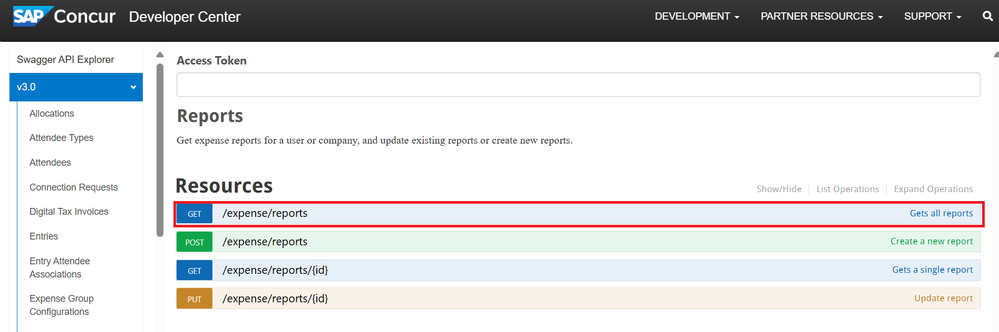

Can you check below API:
https://developer.concur.com/api-explorer/v3-0/Reports.html

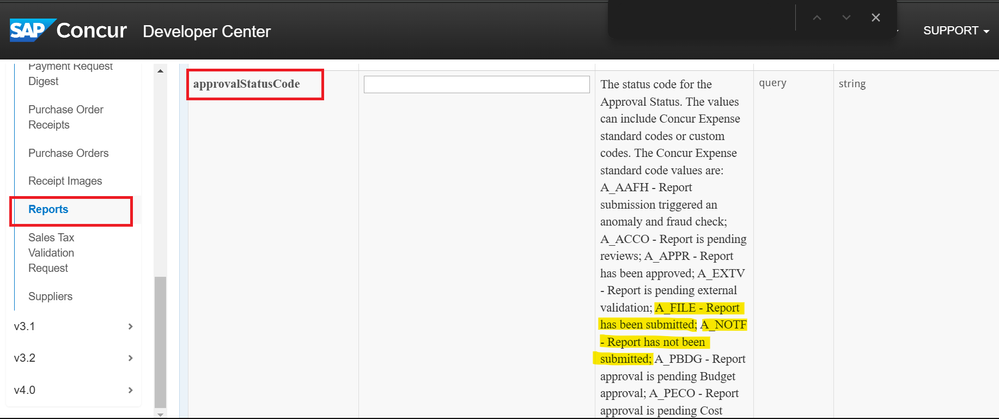

As per my understanding you can get reports with different different statuses using below API. I have highlighted code for Not submitted and submitted status.
Also, would suggesting using only 1 user for testing purpose, if it works then you can think of all users as I could see you have mentioned /api/v3.0/expense/entries?limit=100&user=ALL
possible that API needs exact user or employee id as per Concur to get report details. So, try with only 1 user and check if it works.
