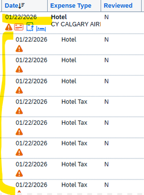

This started a couple of months ago, and is not impacting all hotel expenses. I haven't been able to pinpoint what may be causing it, so throwing it out here to see if anyone else is experiencing this / any suggestions?
We're noticing that in some instances after an employee enters and itemizes a hotel expense (this applies to both expense card and out of pocket expenses), the transaction dates for all itemizations default to the date of the expense, even though the date range is entered correctly in the expense (example below).
This never used to happen before, and can be very time consuming to fix up (for the processor - if an expense is for a week hotel stay, it can be a lot of lines to adjust, for the employee / approver - time consuming to send back to adjust, and leaving it as is is not an option as then these are flagging as duplicates).

@marinapagnotta this issue should now be fixed. Can you report back to me if you are seeing it working correctly, please?

Hi @KevinD . You mentioned back in April that a Concur team was going to be looking into these hotel itemization date errors. Any updates on that? We're still seeing date errors frequently. I think it most cases, I see e-receipts attached. Could they be overriding something / is there anything we can do besides disabling e-receipts to test this out?
@marinapagnotta our internal ticket still says Unresolved. What I can tell you is that according to the logs, ExpenseIt is working correctly. There is something else causing the repeated date issue. I don't believe they have determined what the cause is yet.
Solution

Hi @KevinD , thanks for the update. Since I'm on the review end, it may take a bit of time for June expenses to come through into Accounting Review, but I will let you know what I find, once they do.
marinapagnotta
Occasional Member - Level 3
Hi @KevinD , from what I can see, the dates are flowing in correctly for the most part now. Thanks for the updates on this.
@marinapagnotta great to hear. 🙂
