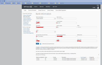

Hi Kevin, I am not the original poster, but this affect me too. By following your instruction I can add new bank details (which I have done) but I cannot delete previous details for accounts no longer in use. The old account remains active and there does not seem to be any way to delete this. Where is the Delete/Edit button for existing accounts?

`thanks for the reply. All accounts are listed. The old bank account cannot be opened, and the status field cannot be changed.
@pauldoc could you please provide a screenshot of your entire screen for me?
Of course:

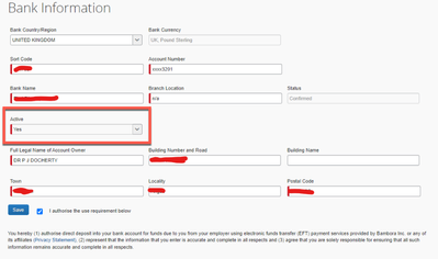

@pauldoc you need to change the Active field from Yes to No for the account you no longer wish to use. See highlighted field below.
Thanks Kevin - That screen is my current, active bank account - I don't want to make it inactive. I want to make the other account inactive - but I can't see how to open it up on the screen so that I can change that field.
@pauldoc I found out that when you add a second bank account to your profile, the newest bank account will be the one used for reimbursement. So, even though you have an old bank account listed and the status field says Active, the system will use the new bank account since it was the most recent.
Thanks Kevin, mystery solved. I wondered if that might be the case. Although it shouldn't really have taken me weeks of trawling forums and trying to negotiate the platform to fix it. The company might want to consider removing inactive bank details as I believe it is not legal to retain such personal information beyond the period of business need.

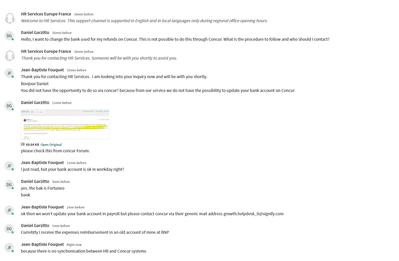

dear Kevin , I do no have in Profile the entry BANK and when i contact the HR support here is what they say, in short not our responsability, check with Concur at [email protected]. Hum, hum,...🤔
@Lostinthefield did you send an email to: [email protected]? I would start there. If you do not see the Bank Information in SAP Concur, then your company must have you provide the bank information somewhere else to get your reimbursements.

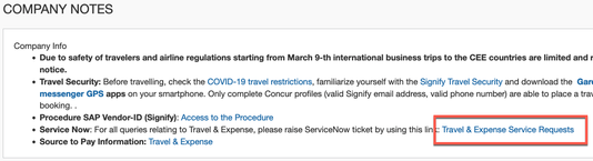

Also, if you log in to SAP Concur, there is a Company Notes section on the home screen. Click the Read More option. You will see a link provided by your company that allows you to submit a Service Request.

and i already spent an hour or so just now with askthea and servicenow and i can't figure what to do. An idea would be if I could manage to be fired, then hired again... that might be the easier way to change my bank account informations in Concur! 😉

If you want to change bank details in Concur, you have do raise a ticket to shuttleforvendor.
Please use link below:
