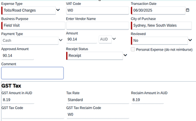

Check the following example from Australia, let's say you see the Tax Code W0 that in SAP is expecting to receive a calculated VAT amount of 10% from the expense total amount in this example (90,14 AUD) then the VAT amount is calculated and you get (8.19 AUD)

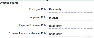

- Update the Tax Posted Amount field and set it as read only for the processors within the Expense Entry form in Forms & Fields. So the processors can't damage the reports anymore from that moment.

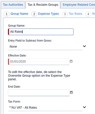

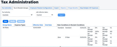

- Change the configuration within Tax Administration with all the relevant changes, to ensure that all expenses are in a group that requests the list of VAT options to the employees. (Creating a VAT form within Forms & Fields, Creating a VAT list within List Management, assign it to the VAT Form previously created and assign the VAT form to the Tax Group (for example All rates and adjust the conditions with the new VAT list) within Tax Administration, below some screenshots for an example in Australia but if you are a Concur Administrator you will know how to do it (just not to make this article super long)

-As explained in the article above, set the Tax posted Amount field within the Forms as Read only, this will avoid the changes from the processors.
-Check the Tax codes setup within the Tax administration if you think or are sure that the system is assigning incorrectly the tax codes, the system will work the way you configure it.
