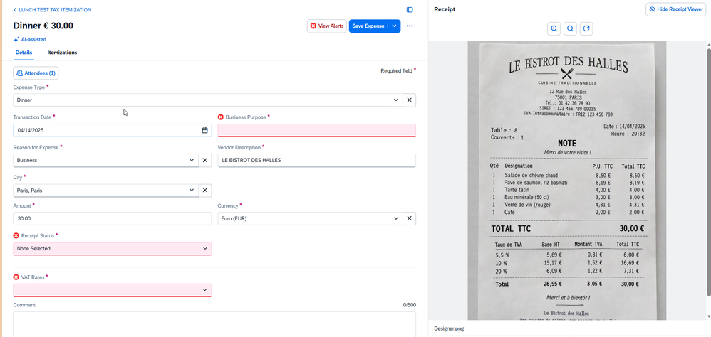

Hello,
There is some enhancement plan on future release from SAP Concur regarding the automation of the tax itemization if multi-Taxes amounts appear?
We test and the OCR expenseIT does not recognize taxes.
We are deploying Concur for French companies, and they get Notilus that manage very well this automatic itemization.
I understand that it is plan on Roadmap.
Can you please give me more detail.
Thank you

SAP Concur ExpenseIT_OCR does not recognize Taxes
Based on your screenshot, ExpenseIt recognizes the €30.00 receipt total but does not extract the
three French VAT rates (5.5%, 10%, and 20%) or their respective tax amounts.
This is an issue with the automatic multi-VAT extraction and not an OCR failure.
ExpenseIt's receipt recognition does not guarantee Automatic Tax Itemization across multiple VAT rates,
even when the receipt clearly displays the tax breakdown.
For now, ensure French VAT Tax Codes and itemization rules are correctly configured and
manually enter the separate VAT amounts wherever required.
