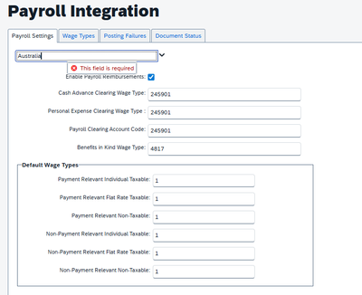

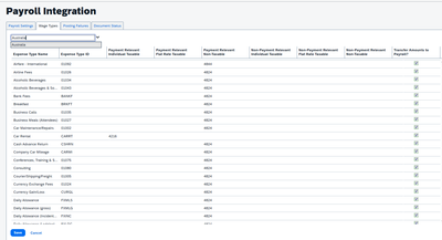

however we are getting a new posting failure as ' Posting Failed. 001(CTE_HCM_PY): Content missing. Please check wageType. ' where we have the proper setup done in Concur with wage types added to all expense types.
check the below images from SAP Concur setup for wage types. might see same code for all, for testing purpose we have added same. in JSON file we see the WageType field coming as 'Null'. did we missing anything?
