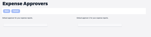

@Niek so, I went into your company's site and you do not have a default approver assigned to your profile.
Could you have your site admin take a screenshot that shows you have an assigned manager, because based on what I saw, you do not. My guess is the site admin looked up your profile from the Travel search options, which does show you have a manager, but that is for Travel related things. You do not have an assigned manager for expense approvals. The screenshot below is taken from your profile settings. You can see that the Default Approver fields are blank. You will need to explain to the site admin you spoke with that they were seeing your assigned travel manager, not your assigned expense approver.
