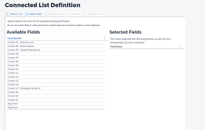

@rohanpatil thats good point. but no use. attached teh connected list definitions page in concur in employee form level where it is showing only the custom and org fields and no other system fields

@Karthikhemadri This is what I see as well. However, I thought that this was due to the fact that our employee group is a single level list. Best to ask the Concur consultant who has setup the employee group as a two level list for your client. Sorry that I cannot offer more help here.
As I said earlier, going with an atypical setup can lead to other unexpected issues in the future. I would avoid it if I could.
