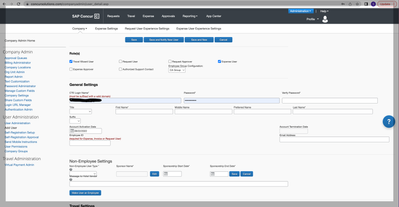

samirshah
@KevinD here is a screen shot.
@samirshah a few things:
1. The screenshot is not a view of our Standard configuration, so that makes me think you are using Standard Expense with Professional Travel.
2. The screenshot is showing the profile of a single user, I need to see the screen that comes before the one you sent me.

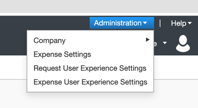

3. If you could sign in and mouse over Administration in the upper right corner and screenshot what you see there, I can better assist.
samirshah
@KevinD
here is the screenshot requested:
Solution
@samirshah yes, I was correct. You are using Professional Travel with Standard Expense. From the Administration drop down, select Expense Settings. You will see several tiles, one will say Access to Concur>User Accounts. Click Edit. Then you will see what I provided in my previous post where you can Add Users from Spreadsheet that will bring in all the users you currently have. Try that and let me know what happens.
