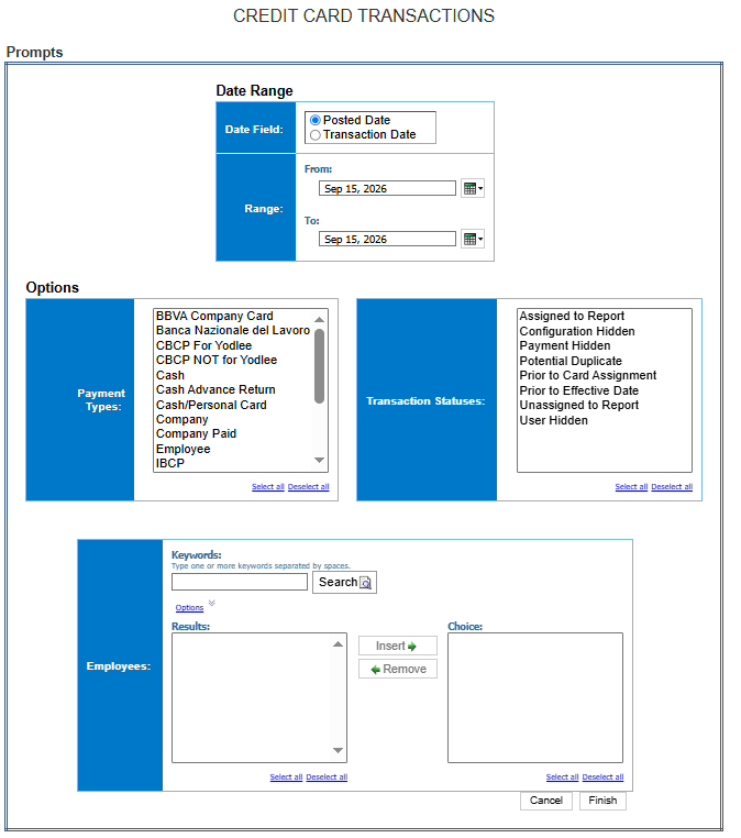

If the transactions are visible in Concur but do not appear in Cognos, I would first review the report parameters. Many credit card reports use the Posted Date instead of the Transaction Date, which can cause some transactions to fall outside the selected date range.
I would also check whether any filters are applied for:

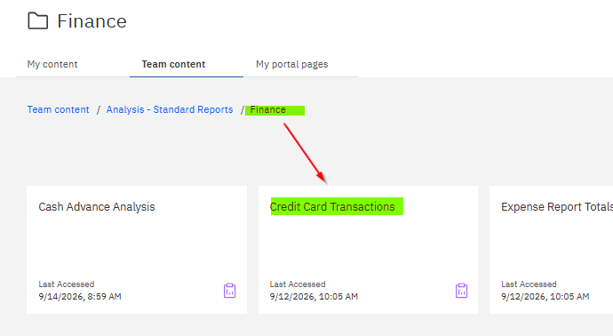

As an additional validation step, try running the standard Finance > Credit Card Transactions report, which displays all transactions imported from the corporate card.
(Reference: Report: Credit Card Transactions | SAP Help Portal)
