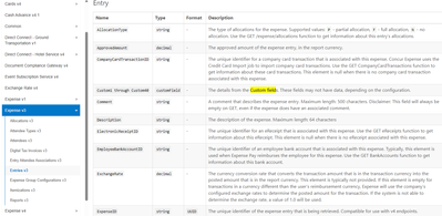

Update: I did find in the Expense V3 API there is an option for Custom Fields (1-40), but I am still unsure if this is the correct approach to take.
