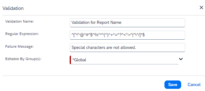

I would like to create a validation to be used on the Report Name to restrict use of multiple special characters. Is there syntax that will build such a validation?

Hi @Virginia13 ,
Please try below regular expression and add validation under Report Name field.
In this, if you want to add any other special characters then you can add using ^special char in this format.
^[^special char1 ^special char2 ^special char3.....]*$

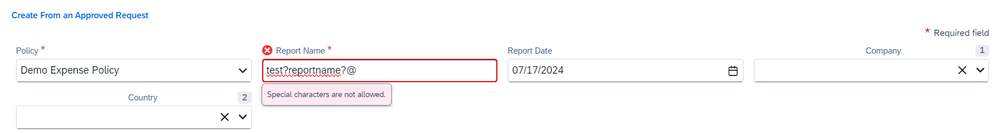

Testing:
Thanks!

Thank you Pooja. This is exactly what I needed.
