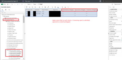

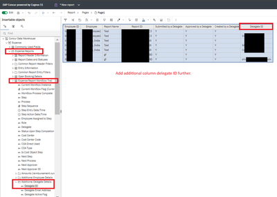

Hi @zjra14 , @CEL22 , @dxh798 ,
I tried below report in our sandbox. It contains reports submitted, approved, created by Delegate (Y) and respective delegate ID. Unfortunately, there is no further actions/audit trail can be added into this report because such data objects are not available under delegate folder.
Thanks!
