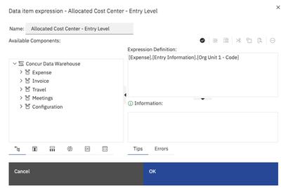

@tinaamundson alright...I had to get a little help, but I think I will make your day. Are you ready?
So, open the report in Edit mode. Near the top click the little arrow next to Report. From the drop down, select Query. You will see a list of all the data items. Double-click Allocated Cost Center - Entry Level. The expression editor will open. You will see the expression for the data item. Replace the current expression with: COALESCE([Expense].[Entry Information].[Org Unit 1 - Code],[Expense].[Entry Information].[Custom 13 - Code]). Click OK.
That should do it. I would recommend making a copy of the report first before making the changes so you have the original. I provided a couple screenshots for you.

That didn't work for me, none of the data has changed with this entered.  I guess I can pull the data as-is and create a formula in Excel to pull the data.  Thanks for giving it a shot!
@tinaamundson oh man...I was hoping that would work.
