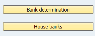

  • For CBCP the clering account is what in SAP we call Bank Clearing account.
In old SAP implementations, you have a Bank Main account and as many clearing accounts as you needed related to the main account (payments, collections, cc...).
You can find all those accounts checking transaction FBZP, last two options:

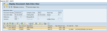

CBCP posting looks like that
Bank clearing account should be cleared once you upload the bank statement.

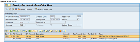

  • For IBCP the clering account is what in SAP we call vendor or BP Creditor Role.
IBCP posting looks like that
Clear the Creditor account with you payment process.
