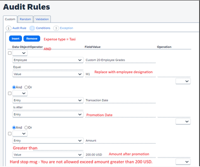

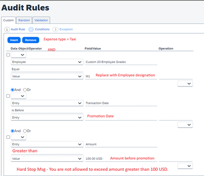

Hi @Reetu_Ratn ,
You can create audit rule as shown below for before and after promotion limits.
Thanks!

Hi @Reetu_Ratn ,
I have done slight changes in rule and updated screenshot in my earlier response. While trying in your system please consider those.
