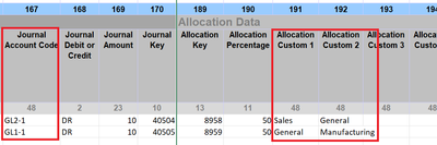

Hi @lenydasilva ,
The answer is yes. For that what you need to do is:
1. Create a 2 level connected list in list management with the above structure as you shown.
2. Add that connected list to allocation form.
3. In accounting structure - Use those 2 allocation fields to create accounting structure.
4. Under Account codes - under main ledger >> add sub ledgers (2 levels) as shown below.
Note - please ignore my allocation field labels. Assume it is a sub ledger field name.
5. Now define different account codes under main ledger (SAP) and sub ledger (level 1 and level 2).
6. Create expense report with expense entry and do 50-50% allocation. While allocation, user can select different sub ledger (level1 and level 2) for each allocation entry. (sample screenshot as shown below)
Note - I have taken same sub ledger as you given in your previous response for your easy understanding.
7. Submit and approve expense report from all level. Once fully approved, extract it and place it into SAE extract template and check account codes as shown below:

Hi @lenydasilva ,
