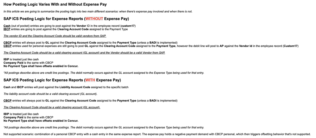

jlozano79
Hi Kevin,
In reading this thread , I understand that if our  company credit card is set up as CBCP  and the user tags an expense line as "Personal Expense   (Do not Reimburse)" it will still generate FI  Posting. Does this apply for “Out-of-pocket” payment type?
I have a user with a specific case  and while these expenses are out of pocket, the company Will Not  Reimburse the employee in this scenario. But we still want those expenses to hit our books in SAP, So wondering if this option will work..
Thank you in Adv.
Joanne
@jlozano79 This explains the posting logic. Let me know if this helps.
