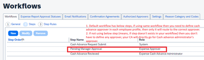

1. Go to Expense Admin >> workflows >> copy default cash advance workflow.

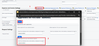

2a. If you are using default cash advance wk as is meaning if workflow contains expense approver step, then you have to define cash advance approver in each employee profile as shown in screenshot 1 and screenshot 2.
Workflow steps will be as below:
User submitted CA >> Expense approver (defined in employee profile) >> Cash Advance Administrator for issuance.
OR

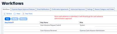

2b. If expense approver step doesnt exists in your workflow (means deleted based on your requirement), then you dont have to define cash advance approver in employee profile. It will directly go for cash advance administrators approval.
This workflow steps will be as below:
User submitted CA >> Cash Advance Administrator for issuance.
3. Go to Group configuration >> Expense tab >> double click to open group >> under cash advance configuration, select your CA workflow >> Save

Request with Cash Advance:
Configuration:
1. Go to Expense Admin >> Workflows >> copy default cash advance workflow.
OR
2b. If expense approver step doesnt exists in your workflow (means deleted based on your requirement), then you dont have to define cash advance approver in employee profile. It will directly go for cash advance administrators' approval.
3. Go to Request Policies >> Open policy >> under cash advance workflow, select your CA workflow >> Save
