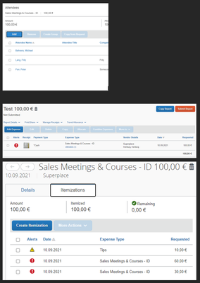

mbehrens72
First step: create food cost and add 3 attendees
Second step: Split (create Itemization) for the three tax types needed for Germany
> food is 19%, drinks 7%, tipp 0%
Problem: for the single splits the attendees need to be added again
> when you have lots of invitations with lots of people, this is getting annoying. Why is SAP not copying the attendees I already inserted "from the root entry"?
Solution
@mbehrens72 Okay, I see what you are talking about now. In all honesty I don't know why the attendees do not copy down. I think, and I could be wrong, that when you add an itemization, the system sees it as its own separate entry even though it is part of the root, so it still requires the attendees. I can tell you that the system can be configured in ways to avoid this. For example, if your company were to add expense types named Food and Drinks they can make these expense types available only when itemizing and they can set these two expense types up to not require attendees. I believe this is more how the system is designed to work and should be set up. Expense types that require attendees aren't usually also used as an itemization.
