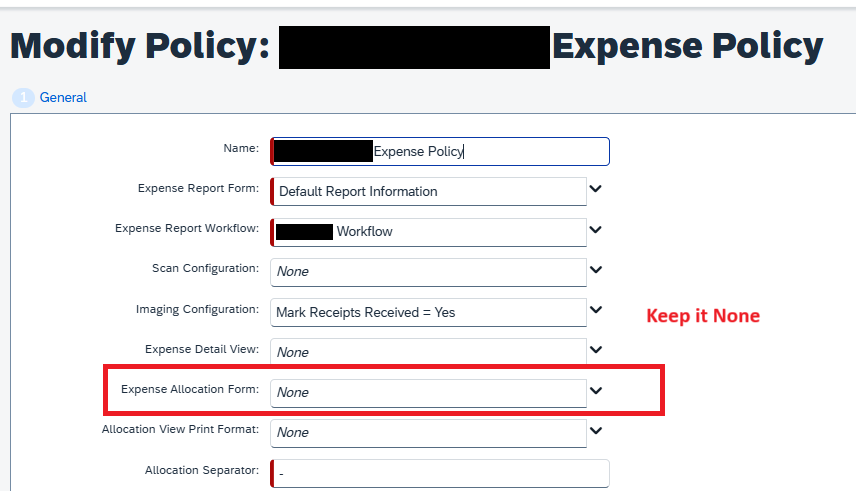

However, as a workaround, I would suggest not to use allocation functionality and consider cost center field in expense entry form. So that user would be able to select only one cost center without having any choice. This is the best way to make this work.
I have tried this from my side, and this is working as expected.
To remove allocation functionality, you can go to Policies section and under Expense Allocation Form section select 'None'. This will remove allocation option/button from all the expenses.

Since on allocation form, we don't have any standard fields and standard data objects in audit rules section, technically it is not feasible to restrict expense type from allocating to multiple cost centers.
