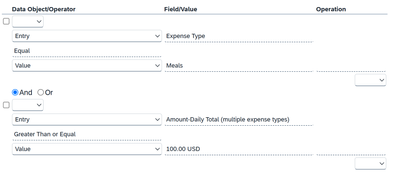

Could you please try using Daily Amount Total Multiple Expense Type. If the issue persists, kindly share a screenshot of the condition so we can review it and provide an alternative solution

@MelGreaves Are you trying to prevent employees from going over a total daily limit or trying to prevent them from going over a limit for Breakfast, Lunch, and Dinner individually?
If individually, as it looks like in the audit rule I can see in your test entity, then I would suggest creating a condition that says Entry Expense Type Equal Meals NZ AND Entry Custom 26 - Meal Type Equals Breakfast. Put these in parentheses. Then add a new condition that uses AND with Entry Amount-Daily total Equal 25.00 NZD. Give that a test. If you need to add the other meal types of Meals - Overseas and Meals - Australia (seems odd though since you are dealing with NZD, then in the rule you currently have created in your Test Entity, remove the open parenthesis from the condition that is Entry Custom 26 - Meal Type. Remove the closed parenthesis after the Meals - Overseas. Now, close the condition of Custom 26 - Meal Type. I think the parentheses placement is causing the issue. Give this a try and let me know how it goes. The Daily Total should be a standalone condition. Also, the Amount Daily Total should not say Equal, it should say Greater than. That's another reason your rule might not be working is because you are likely entering 26.00NZD, but the rule will only work if the amount you enter equals 25NZD. No other amount will trigger the rule, only 25NZD.
