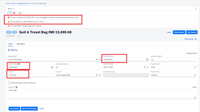

Hi @mkarouni ,
One of our clients has a similar requirement, so this is how we accommodated their requirement using workaround.
Configuration:
1. We need to take custom field with date data type and this can be added either one of below form:
  •  Expense Entry - if added then it will be users responsibility to add last claimed date. OR
  • Employee form - if added it will be employee admin's responsibility to update the recently claimed date in employee profile. Also, copy down source needs to be given on expense entry custom field, so that it will get copied down on expense entry form.

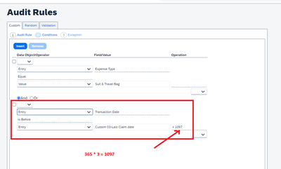

2. Create audit rule as shown below - This is to restrict user if user is trying to claim expense multiple times in 3 years.

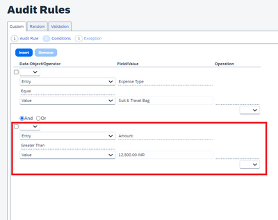

3. Create audit rule as shown below - to check whether user is exceeding specific allowed limit.
Done.
Testing:
Note - In this example, we have taken "last claimed date" field in expense entry form. You can take this field either in employee form or expense entry form or in both the forms as per your requirement.
Also, if user is claiming for the first time then "last claimed date" should be optional or it will be always blank and in that case, you can generate a warning message if needed.
