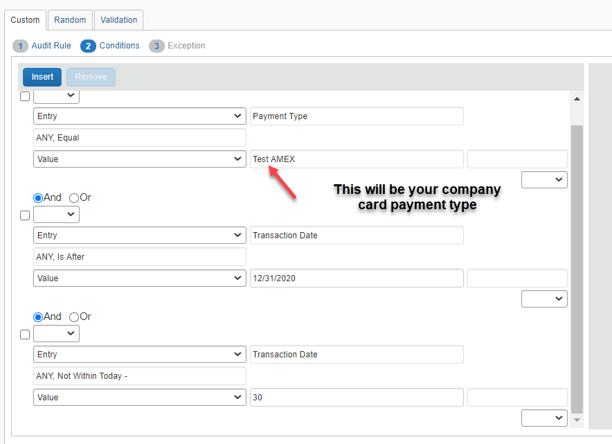

@Karthikhemadri Okay, I may have a solution, but I've not tested it out, so you would need to do so. Unfortunately you won't be able to test this rule out on Test users since it deals with overdue card transactions. I would suggest finding a person who meets the criteria of having card transactions with dates after Dec. 31st, 2020 that are over 30 days old and have them try and submit a report to see if the rule works.
I think you will have to deactive the current rule that is preventing submission of any reports because of transactions that are outstanding prior to 01/01/2021.
I've provided a screenshot of the rule conditions. Again, I've not tested it, but logically, this should work. Let me know how it turns out for you.

The belwo condition works only for teh transactions within the report. However my view is to validate card transaction in "Available Expenses" section and the reports with card transactions and not submitted yet.
I want a rule to check if any card trsnactions that are created after 01.01.2021 and greater than 30 days to current date in "Available Expenses" section and the reports with card transactions and not submitted yet to move/include it in current report.
Once all card transaction are added to current report, system should allow user to submit even though user has card transactions before 2021.
