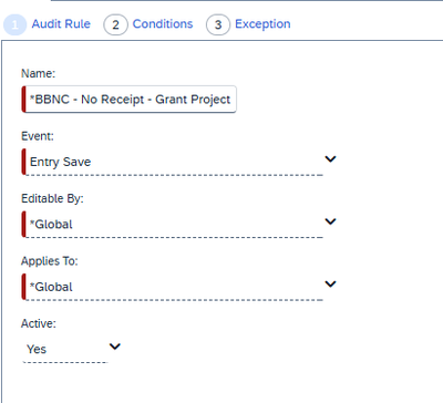

Here is what I did: 1st tab "Audit rule":

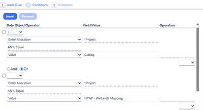

Conditions:
there are a few more in the list AND:

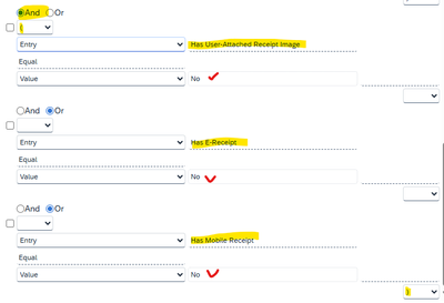

3rd tab:

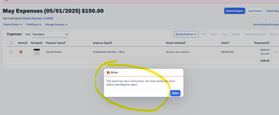

Error when i try to submit to see if it goes away.
