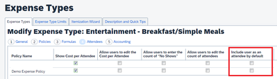

Regarding adding user as a default attendee, you need to do below settings:
With these settings, user will get added as attendee by default. In case if user wants to add additional attendees then that needs to be added manually.
To do these settings, you need Expense configuration administrator (unrestricted) access.

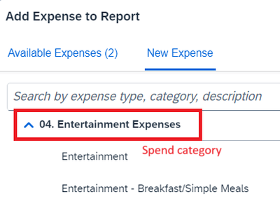

I am wondering the the attendee rule applies to the spend category or the Parent? perhaps I could create another expense type with the same description only available for itemization, that does not require the attendees to be added . ( they will still add the attendees on the expense line where entertainment is selected as the expense type)

Attendee rule is applied to the expense type and not for the spend category. Also, while creating expense type you cannot select spend category. It is just an expense head under which there are actual expenses which as same spend category.
