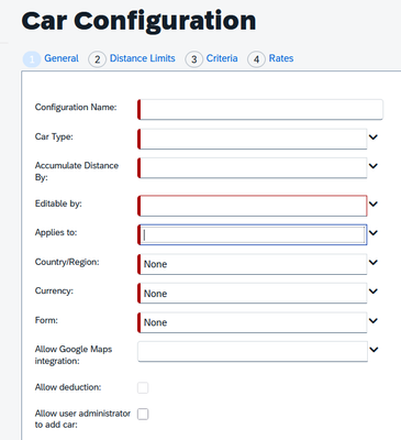

@katwilliams have you considered setting this up under Car Configuration. Just treat the plane like a type of car. You can enter whatever reimbursement rates you want for this "car".
Do you have access to Car Configuration?
It looks like I have access to set up a new one, but it's not something I've done before. I'm not sure what to put for Accumulate Distance By or Form. I can't see what the set up was for the one active car configuration we have.
