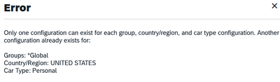

@katwilliams what happens when you select One Rate when setting up a new Car Configuration?
katwilliams
Occasional Member - Level 3
It gave me an error that I could not have two of them.
Meena_K
Routine Member - Level 1
Hi @katwilliams ,
In SAP Concur, only one car configuration can exist for each unique combination of Group, Country, and Car Type. Therefore, the system will not allow the creation of a duplicate configuration.
In this case, I would suggest creating a new expense type to reimburse plane mileage. If required, I can assist you with the steps to create a new expense type.
