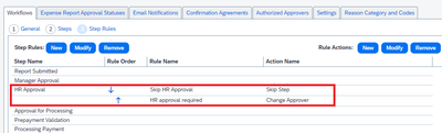

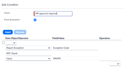

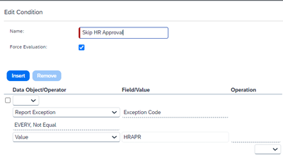

Step 2:
Go to workflow and add HR step in workflow as shown below in 1st screenshot.
2nd screenshot - HR step should skip for those expenses which doesn't require any HR approval.
3rd screenshot - expenses which need HR approval will get routed to the specific person which you have added in workflow under change approver step.
