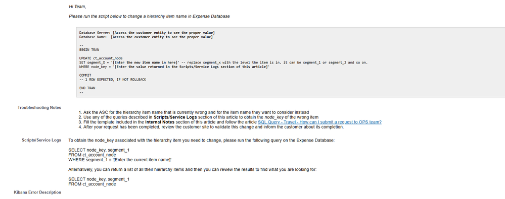

Technically it is not feasible to delete hierarchy line item. Attaching similar Concur support artilce for your further reference:

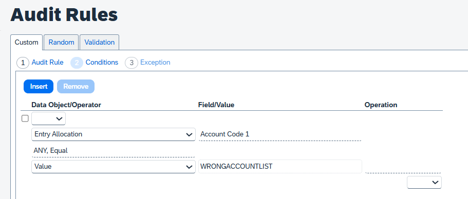

Alternatively, you can try below workaround:
In wrong hierarchy item update some dummy account code for expense types such as "WRONGACCOUTLIST"
Now create audit rule as shown below:
Event - Report Submit
Exception level - 99
Trigger Error Msg - Incorrect account code. Please select correct expense type. (Modify msg as per your requirement)
With this, even if user mistakenly select that above given wrong hierarchy item, user won't be able to submit their expense reports until they correct it. If needed, you can give 1 liner suggestion or msg to the users what needs to be selected to resolve that error msg.
