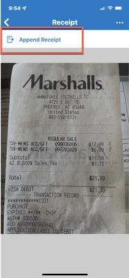

@galvinpaul1718 Maybe you already tried this, but in case you haven't here you go. When you attach the image to your expense, you will now see the image right above the amount of the expense. Press the image. This will then preview just the image itself. In the upper right-hand corner, press the three dots. This will give you options, one of which is to Append Receipt. This allows you to add a second image.

@NTS I just tested this out with ExpenseIt. I added the ExpenseIt item to an expense report. Once added to the report I opened the line item. You should see the image above the expense details (right above the amount). Next, I pressed the image to view it. When the image opened, I pressed the three dots in the corner and had the option to Append Receipt. So, it did allow me to add a second image. Give those steps a try. See my screenshot.

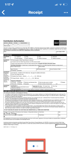

@galvinpaul1718 I tested the two page pdf upload. I attached it using the desktop version. I then went into the report on the mobile app. When you open the line item from the mobile app, you will see the receipt image at the top of the screen right above the amount, Press the image to view it. At the bottom of the image you will see two dots. One is blue, the other gray. The number of dots indicates the number of pages and the blue dot indicates the current page. See screenshot. Swipe from right to left to see the second and all subsequent pages. Give this a try and let me know if it works.
