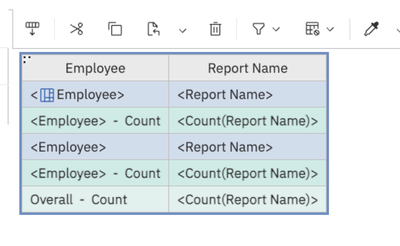

Re: Number of Reports per Employee
If you want these details, I can give you an easy solution. In Query or Report Studio, start a new report. Add the following data items:
1. Employee
2. Report Name
Next, click the column heading for Employee, then use the Group feature. Once the report is grouped, select the Report Name column heading. Once you have done this, click the Summarize toolbar icon. You should see an option to do a Count. That will count up all the reports for the employee and give you a bold footer total by employee. If you want it for a certain time frame, you would need to add some sort of date data item, maybe Created Date, then create a filter for the date range in question. I would then turn the date range filter into a prompt so that every time you run the report, it will allow you to choose the date range you need.
