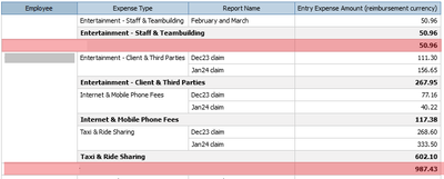

I created the below report in Intelligence, and I want to subtotal the allocation amounts by the first column (rows highlighted yellow in my example).  Doing so shows the subtotal for every column.  How do you hide the subtotals for the other columns (rows highlighted red)?    Thanks in advance!2019-01-08_11-24-25.png

To do what you are asking, you need to open the report you built with Report Studio. Using Report Studio, you can hide those sub-totals by using the Headers and Footers toolbar button.
Do you have access to Report Studio? Feel free to directly message me on here.

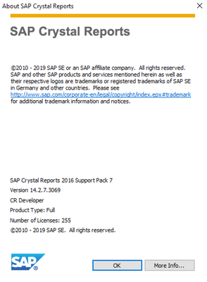

I'm trying to do something similar and hide the sub-totals.  SAP Crystal Reports 2016 >  crosstab.  Help...
@paulooooo98 What tool did you use to create this report? Did you build this in Cognos or some other tool? I'm not familiar with SAP Crystal Reports.

@paulooooo98 I believe those are reports for other SAP products and not for SAP Concur. I won't be of any help here since I deal with SAP Concur solely. Maybe someone else here on the Community has experience with Crystal Reports.
