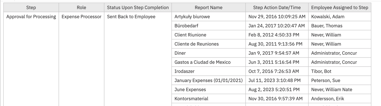

@RicardoBastiaan you can use the Expense Report Workflow Trail folder to build what you need. See screenshot. Be sure to filter Step for Approval for Processing and Status Upon Completion for Sent Back to Employee. That should do it. Of course, you can add more data items as needed.

@ca_murray is this what you are looking for? Of course you can add additional details if needed. I also filtered on Role to only show Processor and I filtered on Status Upon Completion to only show Sent Back to Employee.
Hi Kevin,
Hhmm, yes and no. I have pulled reports with that information on it but even when I specify that I only want the Expense Processor Role entries it gives me entries where reports were sent back by approvers in the workflow and it calls them Expense Processors as well....and reports that were sent back with multiple Reason Codes on them get split into multiple lines, even when the report was only sent back once.

@ca_murray do you think you could recreate where you see the Processor role listed although it was the default approver who sent it back? Also, did you filter your report to only show the Approval for Processing step?
