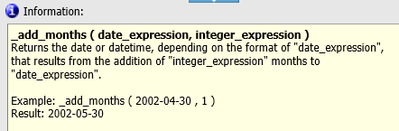

Put the -13 and -1 into the second argument for _first_of_month and the codes run without error:
WHEN 'Last12'
THEN ( [Sent for Payment Date] between
(_first_of_month(_add_months(getdate(), -13) ) ) and
(_last_of_month(_add_months(getdate(), -1)))
The code example for _add_months:
Thanks!

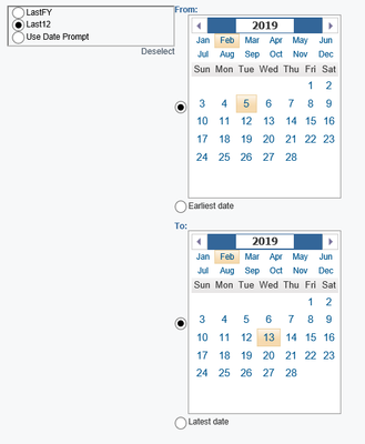

Then on the Paramater page I added a Radio Group with Static Choices and also a date picker. The user can select from the Radio group or choose a date range using the date picker. This allows me to schedule monthly reports (paid in prior month). I can now use the same report and schedule it to run annually.
Let me know if you have any other questions.
Thanks, Mary. I add two parameters and build a prompt page per your description and it works perfectly. Another great and easy way to schedule the report!
(just ignore the ugly looking of this prompt page...)
Thanks again! It's good to have you here.
