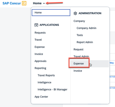

can you show me how this approval workflow is set up or where I can find it? It doesn't seem to be matching our delegation of authority matrix.
@meganmayse it is accessed by clicking Home>Expense.
This will take you to the Expense Admin screen. From here, select Workflows at the bottom of the list on the left-hand side. This will show you a list of your workflows. Select the Workflow, then click Modify to see how it is configured.
Keep in mind that the ability to view workflows will not be available to you if you do not have full site access permissions.
