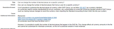

Hi @jyotesh519 i'm asking to see the rounding directly in SAP Concur for IDR currency a client has JPY in their system and the decimals are being automatically rounded in Concur, so they want the same in IDR, but according with the information in SAP Jam it's not possible to set up this feature from the functional area, or do you know hot to perform this within Concur (not talking about SAP ERP)?
jyotesh519
Occasional Member - Level 3
Hi @grodriguezproje Its not possible Customize decimal places of currency within SAP Concur. Please refer the attached KBA for your reference.
grodriguezproje
Thank you @jyotesh519 this is the information that i also get from SAP Jam
